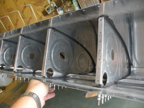

It would be interesting to see the rib design in those Cessna wet-wing tanks. In Van's RV's (at least the -4, -6, -7, and -8 models), the fuel tank ribs have a slot designed into the lower aft corner for the express purpose of allowing water (and fuel) to easily drain from bay to bay. I'm unaware of any problems with water getting trapped in those tanks.
