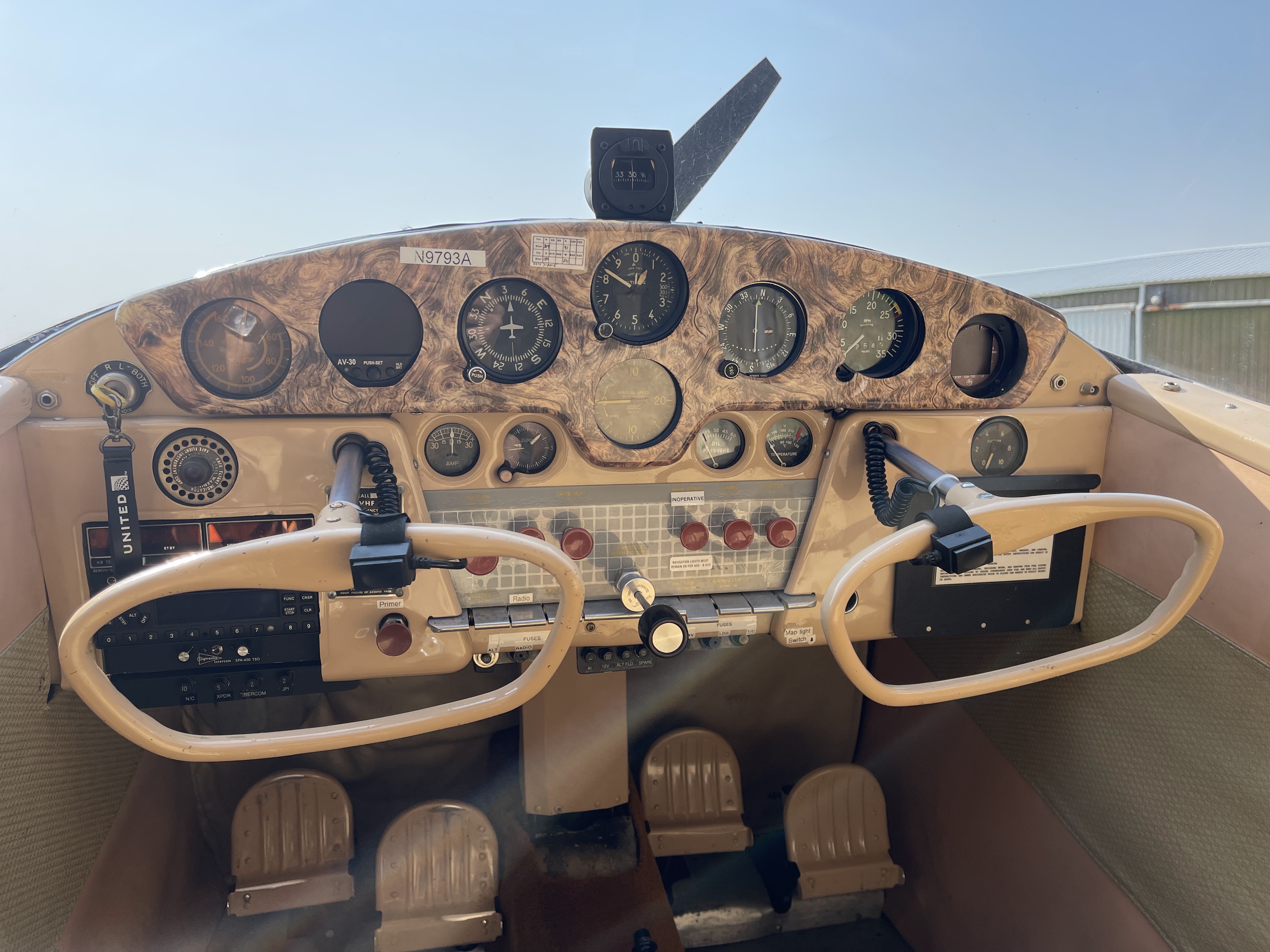

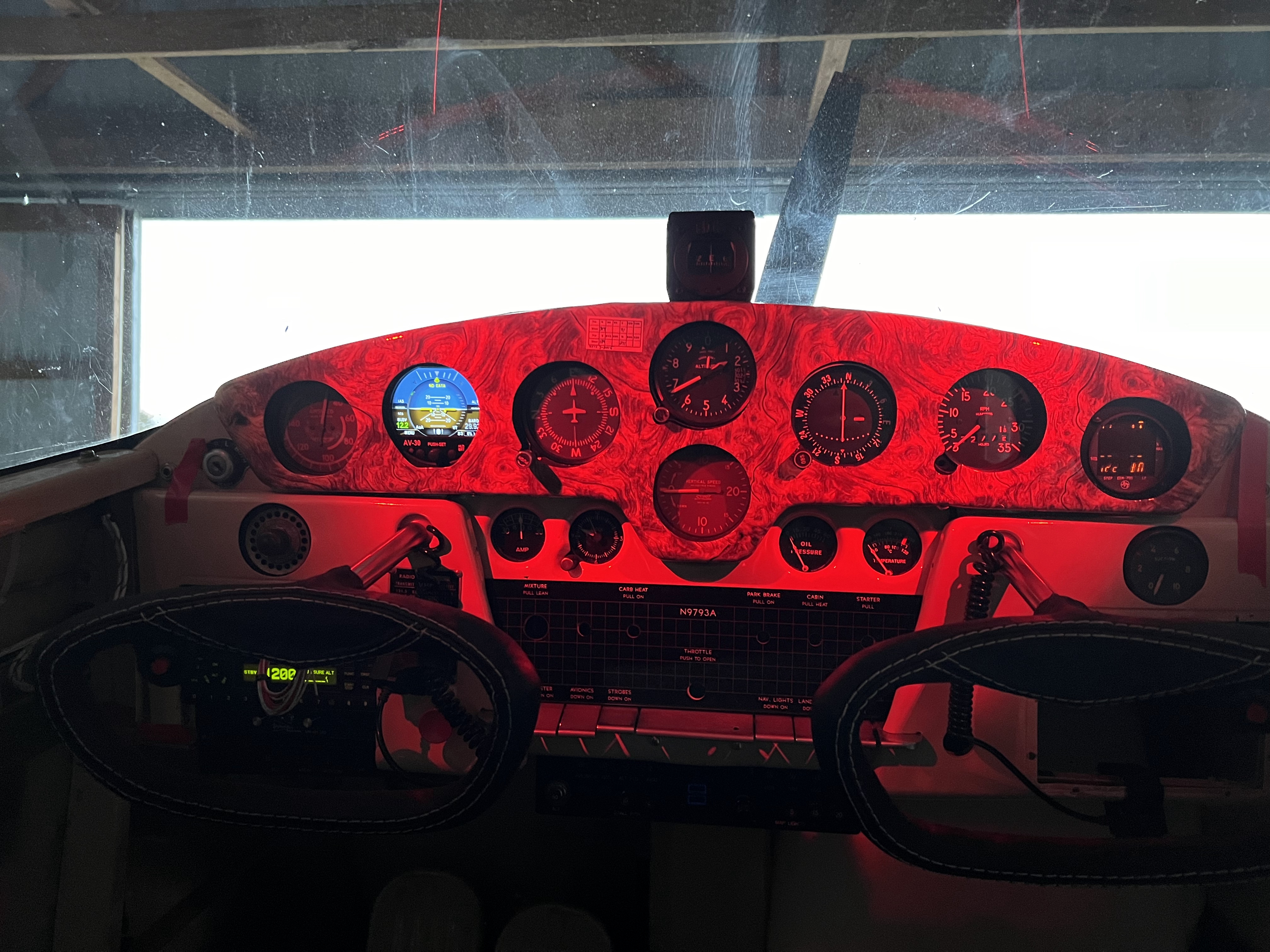

Figured I would post some before and after pics of the interior and electrical work I did the past eight months while the plane was up north at my Hangar in St Helen. We purchased N9793A October 1st and it was out of annual. So we flew it up north and began ripping and tearing to upgrade the interior, majority of the electrical, as well as a host of other modifications and items. Finished the annual last week and bringing it home in the next week or so as it needs to get to Airventure to be on display at our booth.
I left the PN's and such in this post so if anyone wanted to know what was used they can use it as a reference. Sourcing things sometimes was a challenge, or time consuming, so I figured maybe it could help someone save time doing the same things. Proper kudos to this club for such an amazing community and thanks for answering questions for me along the way!!

Installed new Plexi Panel, which is now fully legible and has the proper switch layout for current breaker and switch wiring. (Brian Olson is my hero)
- Owner Produced Part
