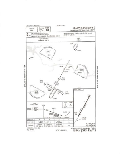

... heading up to Pettit Jean this last weekend we stopped at DeQueen for fuel. One more hour and we'd be at Pettit Jean. The forecast was for 3K-4500 ceilings and 10-15 miles viz. Direct-course took us thru the "Hog Low South" MOA. I picked up flight following with center and they advised "Hog" was cold so I proceeded thru it at 2500 MSL. According to the Sectional the highest terrain in the MOA was 2700, but we were in visual with the ground, made up of east-west running ridges/valleys with aabout a 3500 overcast. Shortly center advised me to contact Memphis Ctr when exiting the other side and to "Be careful.... rising terrain ahead of you... Minimum vectoring altitude in there is 3900." I thanked him and switched to the next freq. and made a call.... no answer. Too low.
A few miles later we ran into lowering clouds and obscured mtn tops and got between the proverbial "rock and a hard place". It was to the point where we could no longer remain VFR, and the mtn tops were no longer visible. I thought about the TTA flight that hit the mountains in this area about 30 years ago, and how stupid it was to try to fly VFR in this area with low ceilings. Doh! It was time to do the right thing. With the MOA cold I felt OK about climbing up thru it, but wasn't feeling too good about climbing up when I didn't know for sure what was ahead in the form of cumulo-granit. We got thru 3,000 and was finally able to get a response from Memphis ctr. I told them what I was doing and they said they could issue a clearance once we got thru 4500, to report passing it .
I did so and they cleared us direct MPJ @ 6K. We were solid IFR in occasional light rain for the next 30-40 miles. At least it was fairly smooth.
When we got almost to the point of a let-down we were asked to "hold at JETSI (the IAF), left hand turns (opposite that depicted in the chart " while a corporate King Air shot the GPS to Russelville. We held for about 3 turns (about 10-15 mins that seemed a lot longer) in rain (had to run constant carb heat and lean it out to keep from missing) and then were cleared for the GPS Rwy 3 to MPJ.
(Larger image available at: http://www.myairplane.com/databases/app ... 5795R3.PDF )
We broke out about 2400 MSL (1400 AGL) saw the airport, cancelled IFR and entered downwind for Rwy 21 and landed.
It would have been smarter to have filed/flown IFR from DeQueen obviously, but the forecast allowed me to hope for a lazier, more direct VFR flight that almost got us into trouble.
I was reminded that it was easier to teach holding in the sim than to fly it in a 170 with AN gyros and carb ice.
