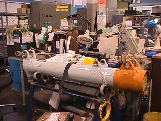

Here's one thats not going to fly again.
Here's one thats had a bit of time spent on it
These are 737 MLG the broken one was found during a walkaround
Care to guess why it failed?

Ah I guess none cares about the 737 gear but it failed due to hydrogen embrittlement. The gear had not spent enough time in the ovens after the chroming process to bake out the hydrogen. Your right a 10x should be sufficient to determine where on the piece the shot peening has taken place.
