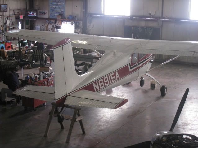

Post by 15A »
Do I need to change my registration to an NR too?
My plane went in for its annual and sprouted another leg! :lol:
It's a 4 wheeler now!
